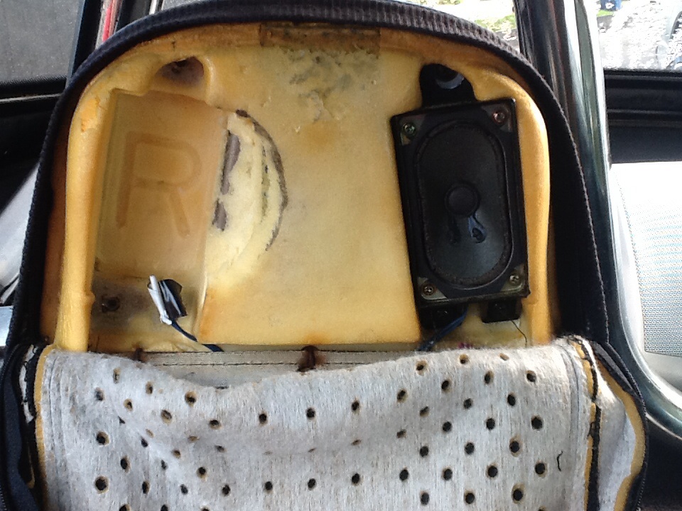

Im going to replace both sets of headrest speakers over the next week.... My query is whether the plastic grills need to be fitted to speakers.... There are some which are more flush sitting than others. I understand that the grills stop damage to the cones. Do the speakers rebate enough to not need them or should i get speakers with a relatively flush finish... Better to ask a stupid question than fix a stupid F#%* Up. Cheers in advance.
I replaced mine with 4 inch speakers (one in each seat), I went for a speaker with the tweeter as flush as possible (fusion I think). It was a bit of mucking around but they sound great, I even have a amp feeding them.
You don't have to put the covers back on as you head does not really touch the headrest most of the time, I did not put mine back as there was not much room.
The only concern I have without the cover is that if I have an accident my head will be hitting the hard speaker not the softish plastic cover.

The speakers should fit snugly in place and you shouldn't have any reverb issues. You do not want to put the plastic covers on or they will not fit.
you will want to cut scallops out of the headrest but cut on an angle so one of the tri-bars on the back of the speaker will have something to support it and hold it square and snug. I have done a pathetic mspaint pic to illustrate what i mean, the red bit is what you cut out.
doing it this way I was able to snugly fit 2 JVC 4 inch speakers in each heatrest and the plastic cover that is attached to the headrest (the bit that folds forward when you unzip it) is more than ample in keeping them in place and protecting them from harm (and cooties)

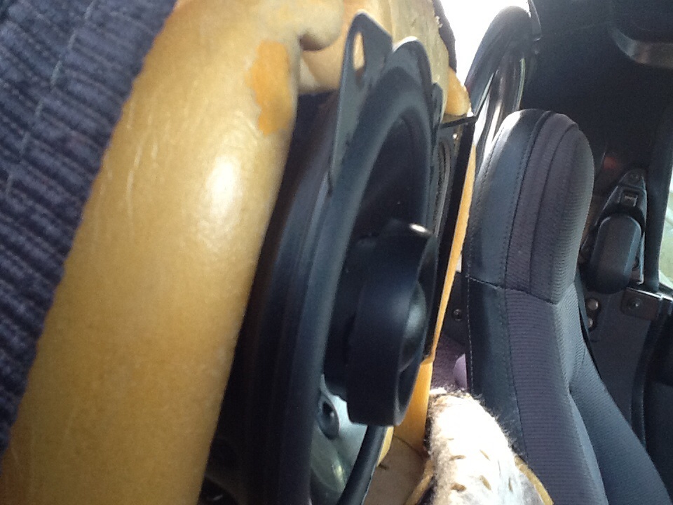

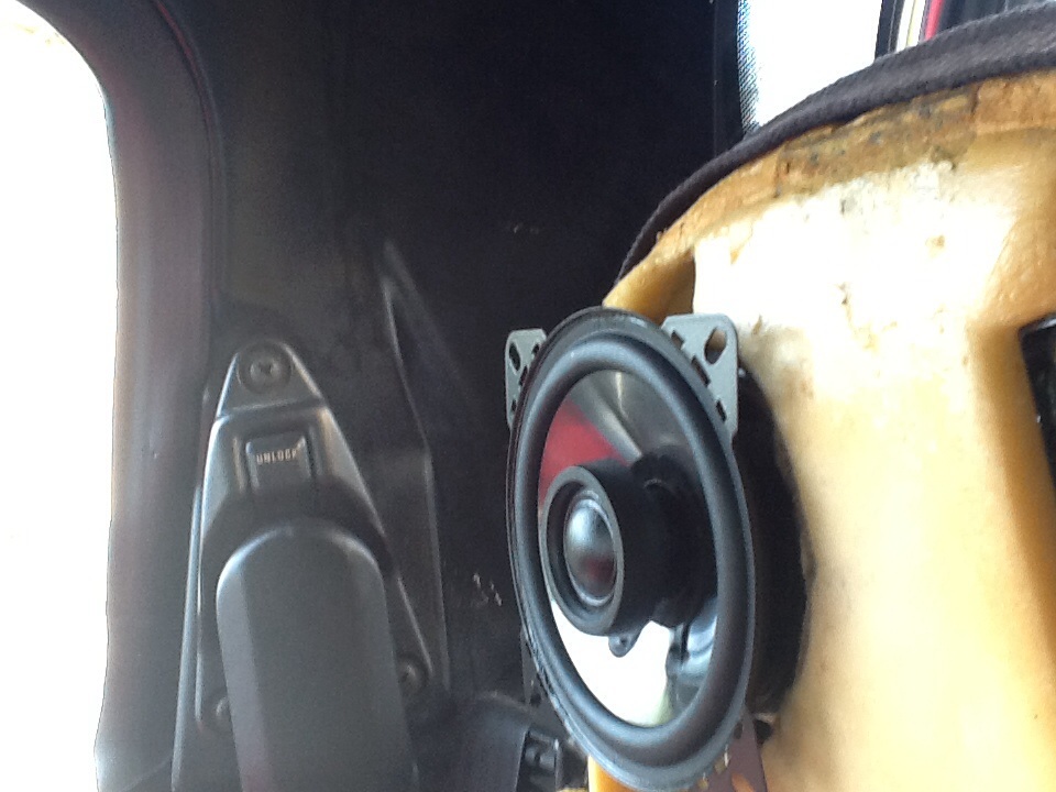

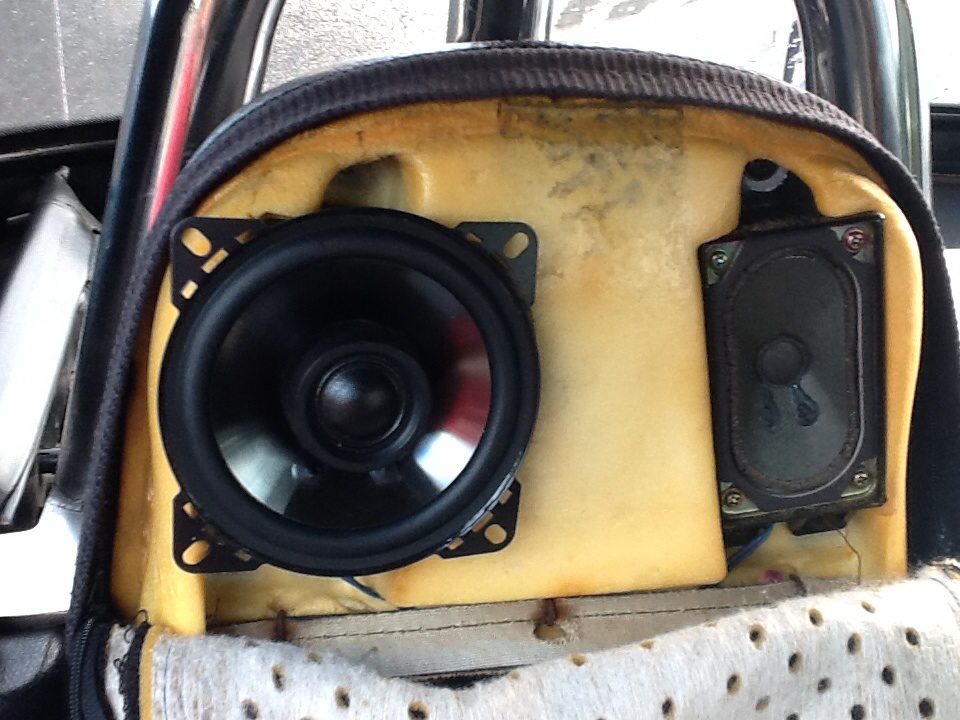

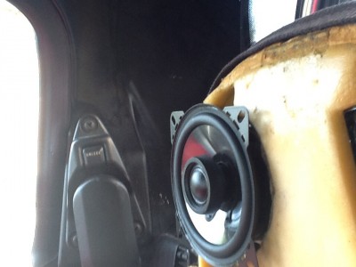

So i I removed the first of the original speakers today and scalloped out the foam until I got down to the reinforcing bar of the seat. Positioned a speaker into the recess but found that the front of the speaker sticks out TOO FAR! The magnet is hard up against the reinforcing bar at present. The plastic segment of the headrest will not sit over the speaker and allow the fabric to be zipped up. The speakers I have purchased are Fusion PF-FR4020. The depth of the speaker is 49 mm or 1-15/16 ". How did others overcome this issue please or do i need to get another speaker that does not have such a large magnet on the back perhaps..... I also found that these speakers would need the mounting tabs removed from the door side of them or they would sit too proud against the vertical area of the fabric cover zip...... Any tips please???..... Im moving on to the door speakers now instead.
- Posts: 1172
- Location: Northland
I hate to say it, but it would appear that those speakers are unsuitable
the central tweeter protrudes too far forward and the overall depth of the speaker appears to be about 10-15mm too proud.
I used a JVC 4" and one edge of the back of the magnet rests on the central steel pillar and yet does not protrude out as far (I didn't use the grilles and its a snug fit when I put the plastic headrest plate back in place)

I thought as much.
Oh well..... Back to the shop. Hope they credit me. They have not been connected yet. One is still in virginal wrapping. Only $30 if they dont and will find somewhere to put them. Even if it is on my storage shelf. Will know what measurements to be looking for now at least on the bright side.... Cheers MrGrey for confirming my thoughts.

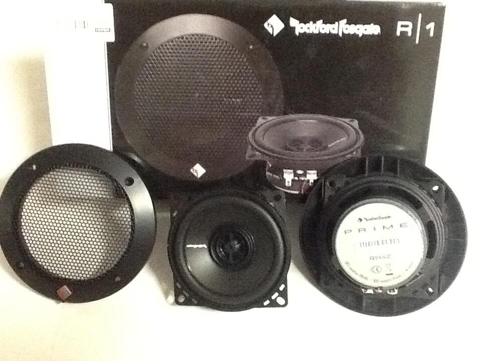

So I returned the Fusion 4's today. Checked out their other speakers and the slimmest they had were Rockford Fosgate. The available gap measures about 40-41 mm but these are 43.6 mm deep. I got them to see if I had hopefully made an error in measurement(with fingers crossed). The speaker juts out a smidge but am still able to insert plastic headrest segment and zip up cloth cover. They are a better quality speaker so will pursue this line.
One of the original speakers was intermittent.... Not sure if a wiring issue or a head unit issue. The wiring behind existing unit is scary. Decided to buy a new head deck as they are cheap enough and just fully rewire circuits. This will save time diagnosing an intermittent situation and does not take long to clock up $90 worth of aggravation in my opinion.
Speakers cost $50 per pair but came with wire and spade connectors so easier to fit than the $30 Fusions. The head deck cost $89. May ahve been able to get slightly cheaper elsewhere but at that pricing I was happy to get all done in less than 10 mins.
Those of you who have retro fitted 4 inch into headrest can you tell me how much spare room you had or what depth the different brands were if you have that info handy????
After only inserting 1 speaker it seems like the headrest will not be as soft as it used to be but head does not sit against it. Prob only hit it in an emergency situation or if i fall asleep... That will then in turn create an emergency. situation.

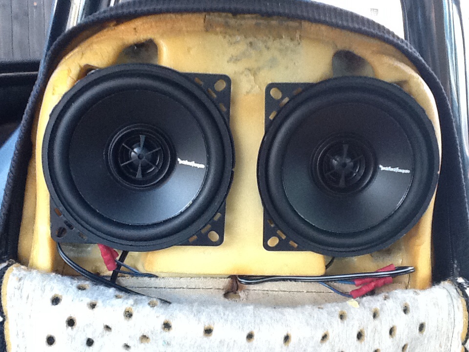

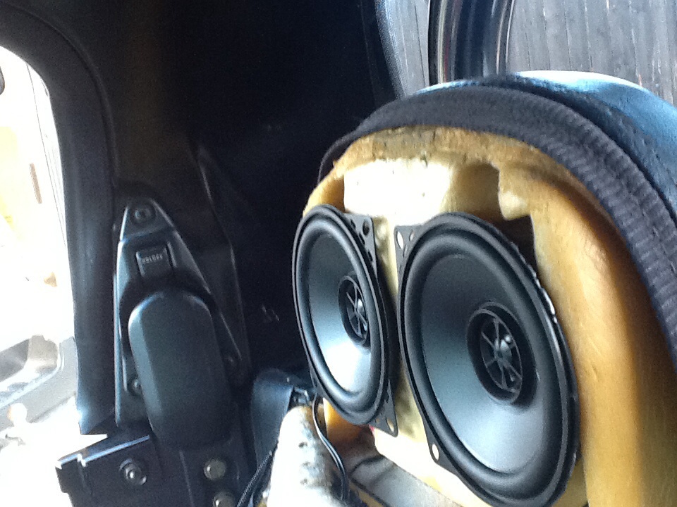

Last weekend was taken up with Automania which exceeded expectations so Im going to finish headrest speakers this weekend..... I need to trim the metal mounting frames down on the outside edges. I would appreciate any comments or ideas on a suitable technique..... I was thinking that I will put wide duct tape over the metal frame edges and also tape a plastic bag over the cones and magnets etc. i figure that if I fully encapsulate the speaker with protective covering and then tape over where I need to trim that I should be able to keep swarf away from the cones and magnets. I thought to have the vacuum cleaner sucking the swarf as I cut the frames. Thought of tin snips but do want any sharp edges. If I hacksaw it and then tickle up edge with a file fingers crossed all should work out ok.
Can anyone offer a better technique or any refinements to my first plan?????
- Posts: 677
- Location: Fastlane to Ak
Could not find my tin snips within the depths of my work van so grabbed my trusty All Purpose Knipex Side Cutters.... These cut the tabs off without an issue. Touched up the edges with a filein no time at all. Cut some more foam out right down to the reinforcing bars. Speakers nestled in ok and was able to reassemble headrest plastic and zip up without too much tension on the zip. The speakers do not sit flush due to the size of the magnets but they are a better quality than those with thinner ones. Photos attached to show finish position. They sound Sweet As. Needless to say Im stoked. Just having a coffee break and Im back out to connect up to a stable power supply so I can use the stereo at night when the lights are on.MrGrey wrote:tin snips and a file should be fine
Had a recommendation to run the Rockfords through an amp as they are up for the task and will perform even better. Will go down this track at some stage but have other pressing tasks to do at moment.
Hope this thread is of use to others who are wondering what speakers will fit. Thanks for the feedback via this thread and face to face.
