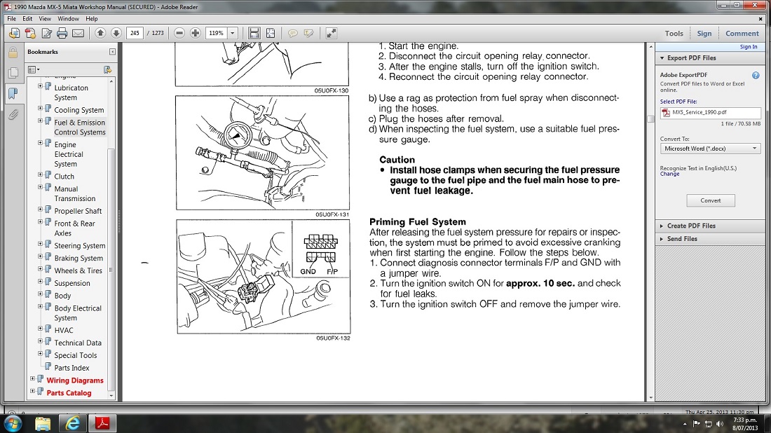

Use the diagnostic box

As WideOpenThrottle says, you can force the fuel-pump on by jumpering the F/P and ground connectors and turning the ignition to ON.
