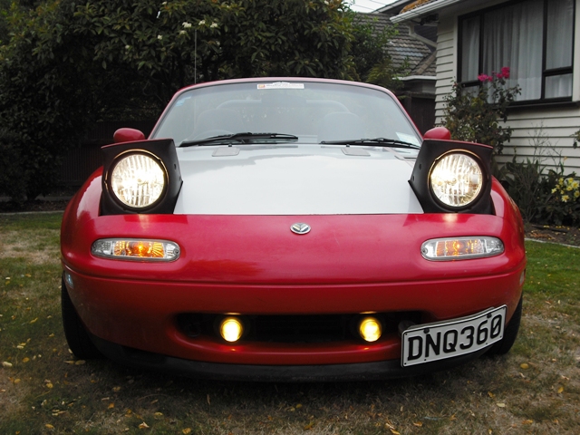

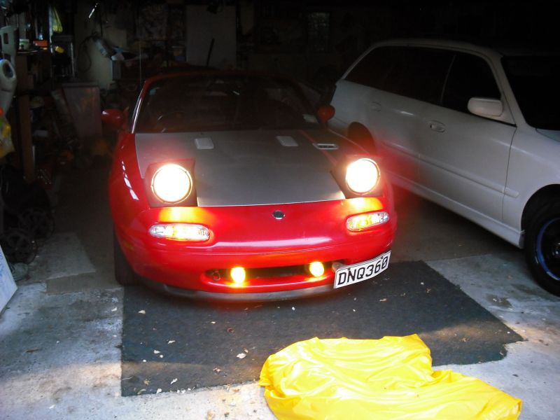

Post by brownie » Tue May 28, 2013 11:50 pm
like these

Post by brownie » Wed May 29, 2013 10:20 pm
i,m fairly sure there are 2 different filament brightness in them,
All i can say is when driving with the factory lights during the day,using your indicator,you can't really see them flashing when you pull up behind another car,With these lights ,you see it flashing,Alot more visible to other motorists as well,They are one of the smaller cars on the roads now days certainly lower than most,Need to be visible
