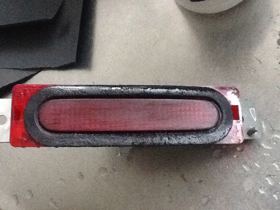

Started new topic so others could follow advice if need be. Further to my fuel issues in general chat was asked why i do not polish my hazy boot lens?......... I have not seen this done before so do not have it in my knowledg bank. What is the best product to polish with? Something like jif or brasso? Big thanks to the replies that get posted. The generosity of forum members to help the less knowledgable is awesome. Its what makes a site like this work for the benefit of all.

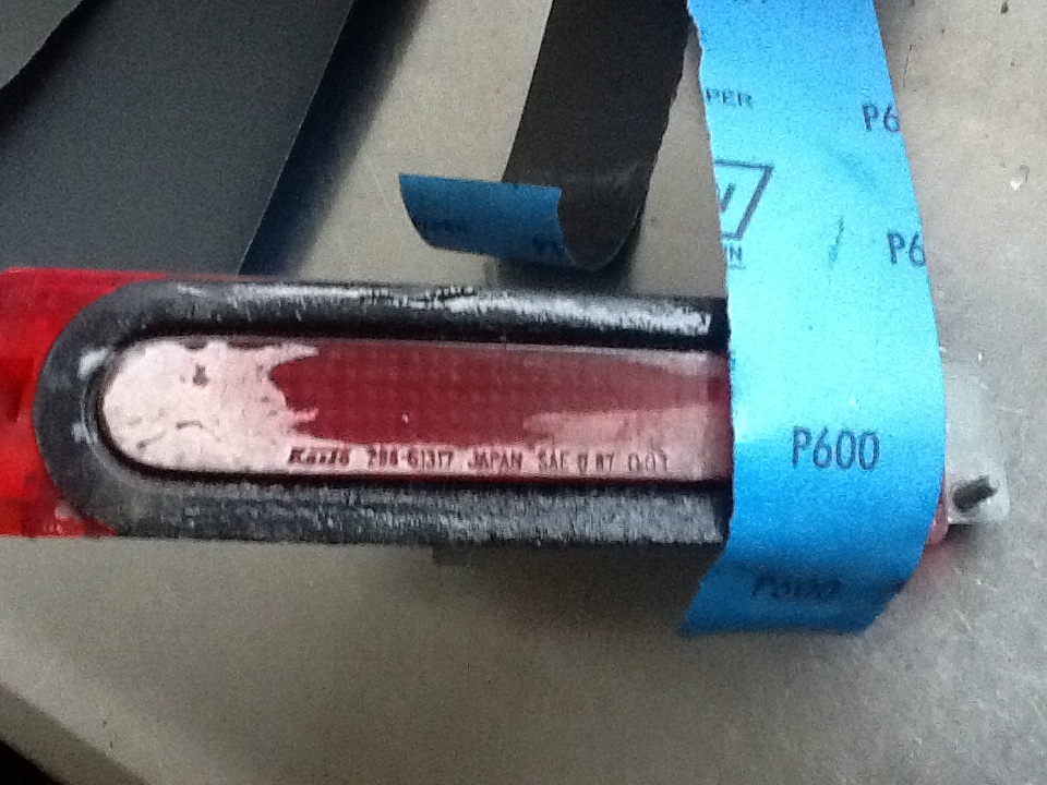

for starters, I don't think that light is required for a warrant, but the photo you linked makes me think that wet'n'dry sandpaper would help. Something like a 240 grit to start with then 600 grit then 1500 grit and then use a cutting compound and polish.
Post by Snapfrozen » Thu Aug 15, 2013 8:06 pm
This shit is amazing. As below. Sand them going from rough to VERY fine paper then use this. NZHondas has a good thread about headlight restoration. Remember to mask around so you dont get your paint
Post by sprsta » Thu Aug 15, 2013 8:08 pm
i scraped all the writing off my lenses when i had it stripped for paint,
dont go as course as 240!
start with some 800 wet
then 1500 wet
then 2000 wet
then 3000 wet
then use a buff to cut them back and make em nice and shiney
its time consuming but looks nice in the end

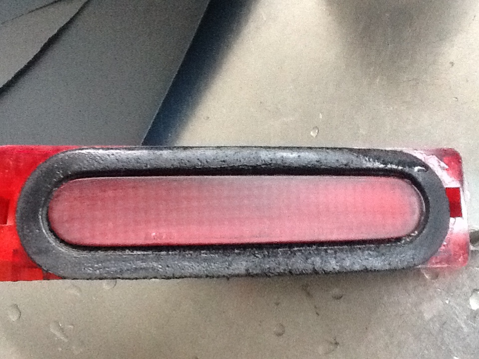

I had a rain off this afternoon so scored some wetndry on way home. 3 sheets $7. Ater about 30 seconds with 600 grit the lens was looking like this.
Then a stint with 800 and then 1200

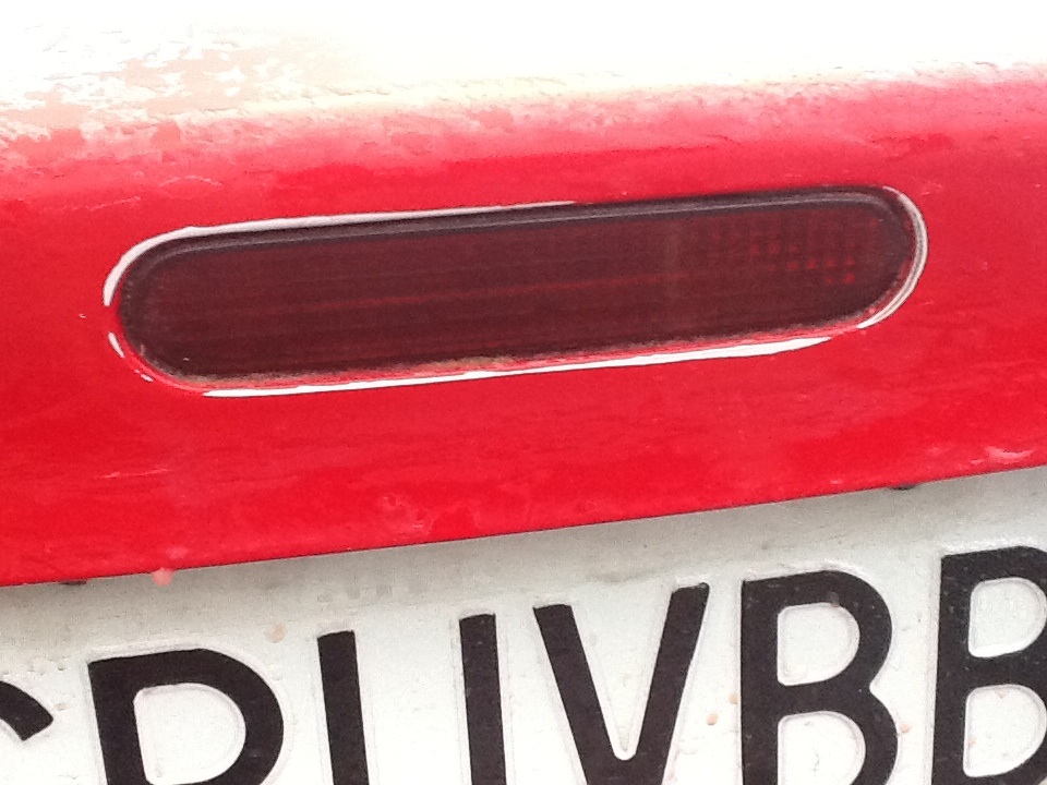

Finally rreplaced lens and hit it with a polishing buffer. Took a bit of paint of around the lip but thats no drama.
Pics appear to have loaded in reverse order sorry. Also got a double insertion of first pic. My first time doing multiple pics.
Thanks for the polishing advice everyone. Hope this is of help and inspiration to others suffering hazy lenses. Im booked for a WOF tomorrow morning so hopefully allwill go well and ill be back on the roads. Just in time for the rain. Should be fun
