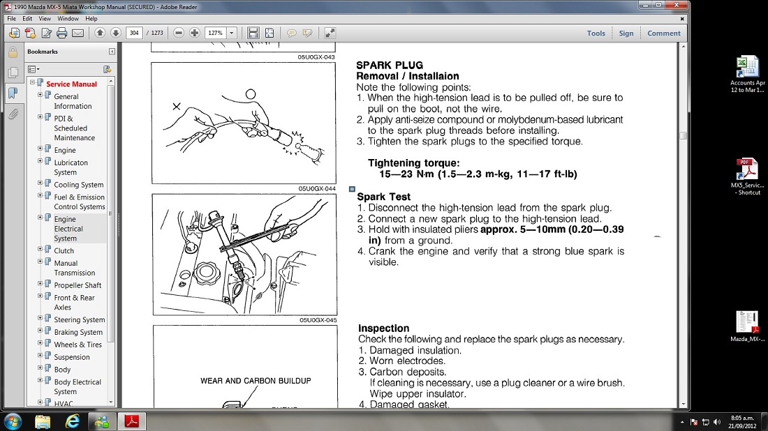

Funny..the workshop pdf says the opposite???SLYDIT wrote:ignitor module?

the workshop manual is only good for things you know but cant remember lol, diagnosing.....fail haha na im glad its sorted, just ticking over the 200km mark on the new engineWideOpenThrottle wrote:Funny..the workshop pdf says the opposite???SLYDIT wrote:ignitor module?
