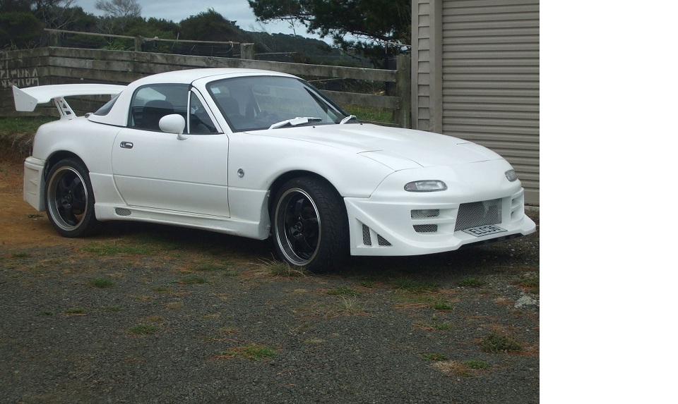

Post by WideOpenThrottle » Thu Apr 22, 2010 12:02 pm
Just got my WOF even with a de-powered steering rack[lucky meeeeeeeeee]! so i got another wheel alignment from another local tyre merchant and guess what? my original problem of it turning too far to the left is still there & i have been told that the chassis may be out a few mm so we are at the maximum adjustment. It looks like i may have to live with it for now.
The 17inch rims & tyres certainly have a mind of there own around "
'S' bends so it will be interesting to try my lighter 15 inchers especially for track days!
I can now get serious with my forced induction! :D
Post by WideOpenThrottle » Thu Apr 22, 2010 12:08 pm
Just needs lowering & some chassis bracing once its turbo'd
