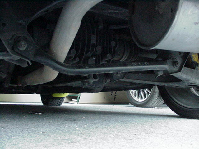

Can you post a picture of it please?poison wrote:...I have an unused one I bought for my NA that I would sell for $50 if anyone is interested.

And here's a pic of the brace.....

A big yes for number one, provided you are referring to the rear end. A look underneath will disclose how the lower wishbone points are out on a limb, and should be connected.
My 1997 as manufactured, has a second set of braces running forwards so as to resist longitudinal loads. All braces are tubular and straight, for maximum compressive strength, just as they should be. Piece of cake to reproduce using scaffolding, or any thick wall tubing.

Racing Beat make an alloy underbody brace (front) wich can be fitted either in place of or in addition to the factory front chassis brace. One of these is on my shopping list as is their front swaybar mounting support blocks. The Flying Miata butterfly brace is tempting, but freight would be a killer, and don't know if I want the extra weight of it, given my modest horsepower (these forced induction blokes don't have to worry! Right Biff??)
Cheers, Ian
93 1.8 NZ new, intake and exhaust mods, torsen lsd,konis and RB springs,Toyo T1Rs.
Roll cage, momo seat, Willans harness.
- Posts: 113
- Joined: Fri May 19, 2006 10:05 am
- Location: Manukau, NZ
Just my $0.02
Hi,
I installed the under car bracing front and rear on my 90 from Ross at MX5 Mart and noticed a good improvement.
After that was the front shock tower brace (STB) from an NB but only noticed a small difference.
It wasnt until I installed the Roll Bar that the car really stiffened up (bolted to 4 points welded). That was the most noticable change by far.
The STB has just been re-installed but did not notice much difference, just a little in the steering.
Regards,
Anthony
Regards,
Anthony
