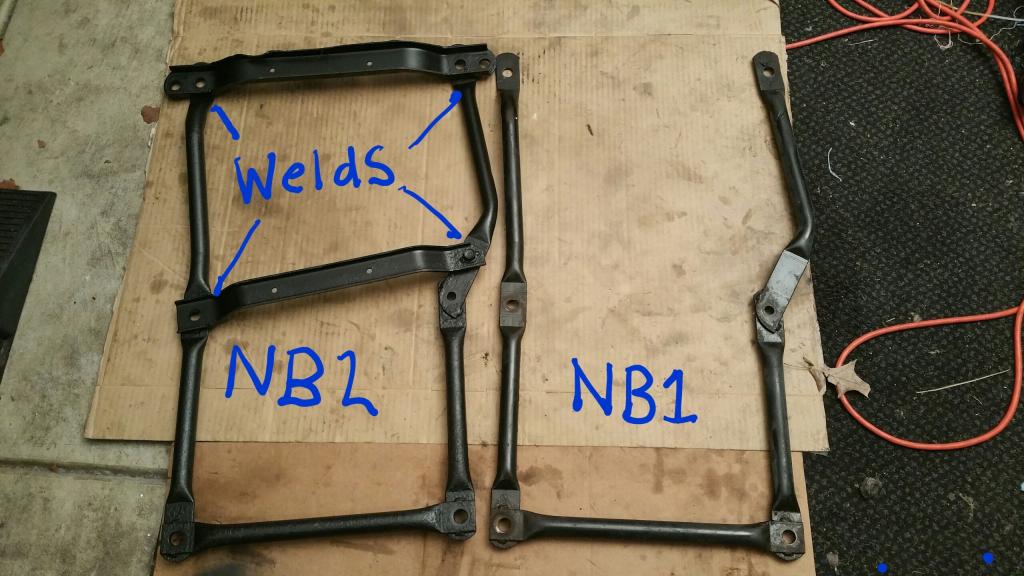

as Keith Jones, said; "There should be a cross brace underneath the gearbox and a series of ladder braces underneath the middle of the car. A cross brace in the engine compartment doesn't do very much as the suspension loads in the MX5 are taken by the subframe, not the body as in a Macpherson strutted car."
did you mean to get this brace?? see picture. i already have this trapezium shaped brace further up front but not the main 'ladder frame' , have bigger sway bar at back, standard adjustable front brace at front above engine . i am considering another brace at back, above just behind the seat (pillar brace?)...thats about it. its so confusing...

- this ladder.JPG (20.32 KiB) Viewed 32219 times

right now I wished to discussed this before the whole ordering, installing of these sway bars..... i did looked under for those standard "ladders" as you mentioned, i couldn't see it at all.
what should I do? revert back to standard, try find some standard mid-braces...? and take car to Autoalign get the shocks sorted, (and bilsteins bushes as well).......what do you think? please reply, I really do appreciate your mx5 wisdom, i just want that car safer, smoother, and get it handling right as it should be when "new"...
