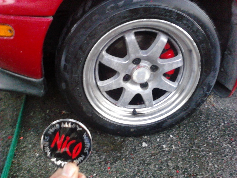

I have to get new tyres for my impending WOF so I decided to give my rims a birthday. Originally they were painted lipstick red so I gave them a repaint with some matt black but now its time to give them some real attention.
I started by using an industrial paint stripper and after about 1.5 hours per rim I got them back to bare alloy. 3 of the 4 rims had a little "Nico" badge so I will remove them and replace them with something a little unique. (suggestions welcome)
Next on the menu is getting the rims touched up by an aluminum welder which has been quoted at roughly $80 per rim (fixing the gravel rash and some dings in the edge of the rims) then I will unleash an etch primer and (probably) paint them completely black. I gather that polishing is a time consuming job so I don't think I can be arsed trying to get them back to as new.
I'll post pics as I go incase some one ever wants to go down a similar path and I'm open to suggestions or tips. 8)
