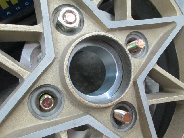

Post by sprsta » Wed Jan 16, 2013 12:45 pm
just had these adapters made they are both hub and wheelcentric so no need for hubcentric rings etc
seem pretty good quality
Post by chris » Wed Jan 16, 2013 12:56 pm
... Star... Sharks.... ? :o
Post by sprsta » Wed Jan 16, 2013 1:52 pm
yes **** insert jaws theme music here***
Post by chris » Wed Jan 16, 2013 1:56 pm
4 x 100?
Wow. I am just in awe right now :o
Post by siren676 » Wed Jan 16, 2013 2:01 pm
Looks to me like 4x114 and the spacer acts as an adapter plate
Post by sprsta » Wed Jan 16, 2013 6:13 pm
siren676 wrote:Looks to me like 4x114 and the spacer acts as an adapter plate
yes they are adapters
