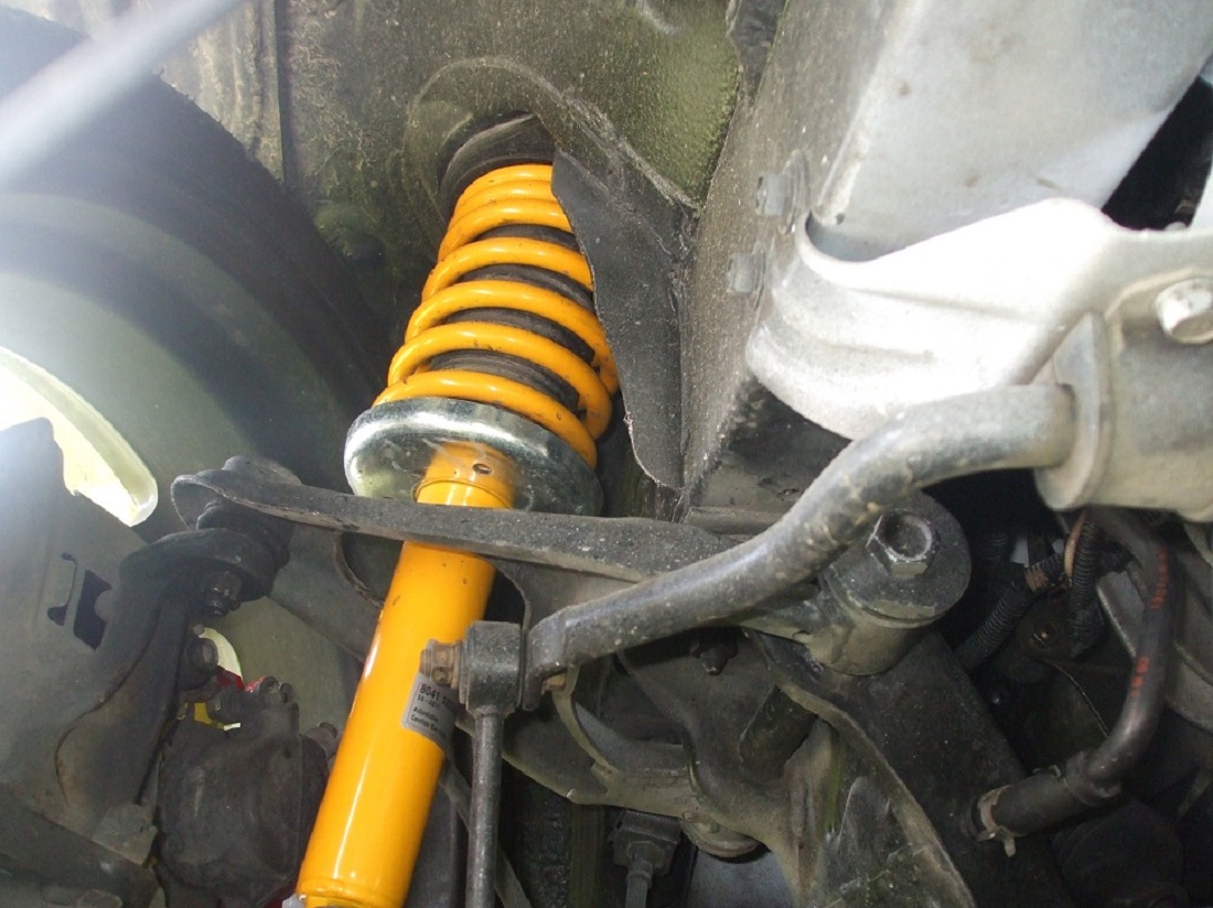

And i got Koni sports...you get 3 height settings [non-adjustable once installed] plus shock damper adjustment from soft to firm.
I got no complaints

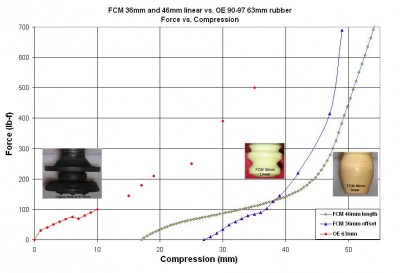

The NA factory bumpstops are pretty big, and designed so that the car compresses onto them when cornering, increasing the effective spring rate.
In most street suspension setups, you're going to be compressing the bumpstop in corners, so the spring rate and linearity of the bump stop will have an impact on the way the car handles. If the car is hitting the bumpstops too hard, the sudden change in wheel rate may cause unpredictable handling.

I'd be cautious chopping up bumpstops though... without knowing the force vs. compression behaviour of them, you might compromise the performance or protection they provide.
Fat Cat Motorsport bumpstop comparison
