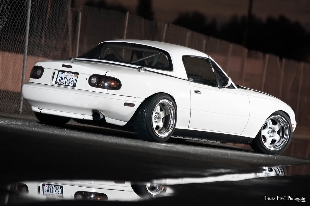

punkoutnz wrote:http://www.mx5forum.co.nz/ads_item.php?id=409
Flared guards but here's Keith Jone's ad for his wheels with 225 tyres on. Could ask him if they would fit in standard guards.
Tyre sizing for 15x8's
Post by jif » Tue Jul 03, 2012 4:29 pm
225/50x15 TE37 et43 on the front ... no probs, apart from slightly rubbing the intercooler inlet at full lock.   Looked perfect !
