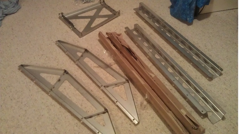

This is more for Sprsta as he'll be installing it for me but I figured people might be interested as well.
Anyhow, they arrived yesterday and I finally opened them this evening and discovered I had a spare set of frame rails (Mad Kiwi's) which was a nice surprise. Shows how much I read paperwork or invoices... Somehow I misread it and thought they didn't send them and that I'd somehow let Mad Kiwi down.
Butterfly brace with spare frame rails that I misplaced between USA and here...

I guess Furai wouldn't like these as you have to drill 28 holes in the floor and "massage" any dents out of the rails before fitting them. Also requires either flexibility or a flexible wrench and lots of swearing...
Miata.net says it takes about 4 hours to get done.

The whole butterfly brace was 350US on a group buy special from FM. Shipping was the expensive bit :roll: but wasn't too bad considering the volume and weight of the numerous items I got shipped over. About 200 for the shipping and 300 for the gst and customs clearance side of things but that was including a whole stack of other stuff.
Installation wasn't too bad. My rails were very bent and required quite a bit of "massaging" with a mallet. All up I think it was about 1-1.5 hrs installation with Cole who is very efficient.
As soon as I drove out I could feel the difference. The car feels tighter, speed bumps don't feel so bad with the whole thing stiffened out, going around corners feels nicer. I'd say the claims on the internet regarding the frame rails and butterfly brace are true.

FYI - I found installation of the rails very easy as well.
Took about an hour and a rubber hammer and a piece of 2x2 to ...ahem..."panelbeat" the rails back to some semblance of square....
Car drives nicely now, I wouldn't say a massive difference on road but the slight hint of shimmy I used to get at 105km is now completely gone.
Overall more a feeling of being more solid as opposed to stiff...car suddenly feels less rubbery, which is odd cause it didn't feel rubbery before.. :)
Having the shimmy gone is a bit odd too, I suddenly discovered I was at 120 km / hour the other day when I subconsciusley thought it was 95 ish due to the smoothness of the ride...normally just under or over the 105 was the natural speed of cruise, seems I will have to be more carefull from now on...
