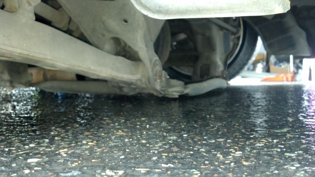

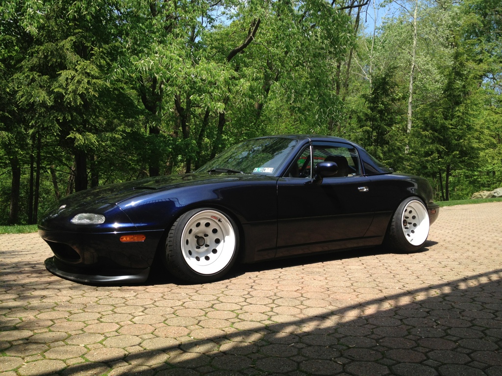

I thought you said you wanted to slam your car?
70mm isnt that low by Club Roadster 2012 standard
This is Mod Slam (roughly 50mm ground clearance)
http://clubroadster.net/vb_forum/showth ... ost1224018
This is Slammage (roughly NO ground clearance :lol: )
http://clubroadster.net/vb_forum/showthread.php?t=13839

Post by Bwarp » Thu May 10, 2012 1:47 pm
Oh right. keen for height of 3rd pic or close to it... thought itd be more than 50mm... hahah all good. Know where I'm headed now!

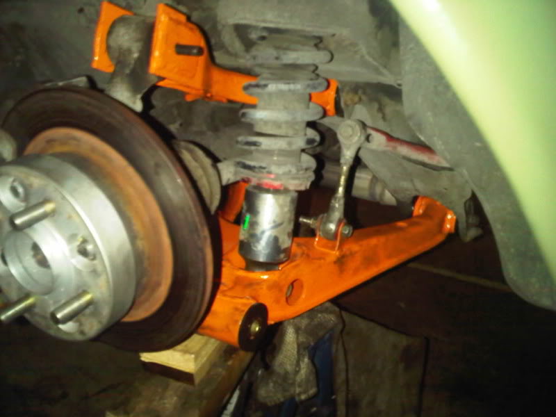

Post by Kieran » Thu May 10, 2012 2:15 pm

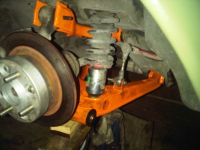

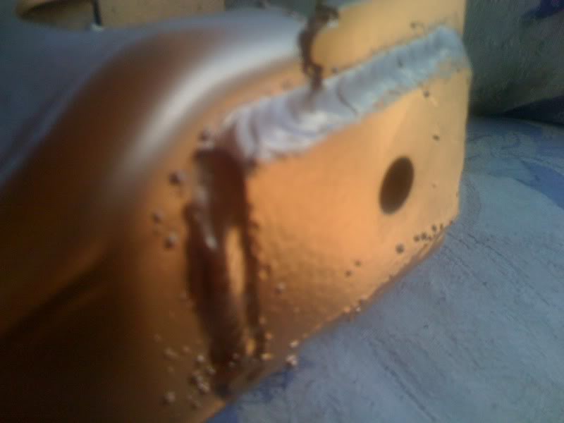

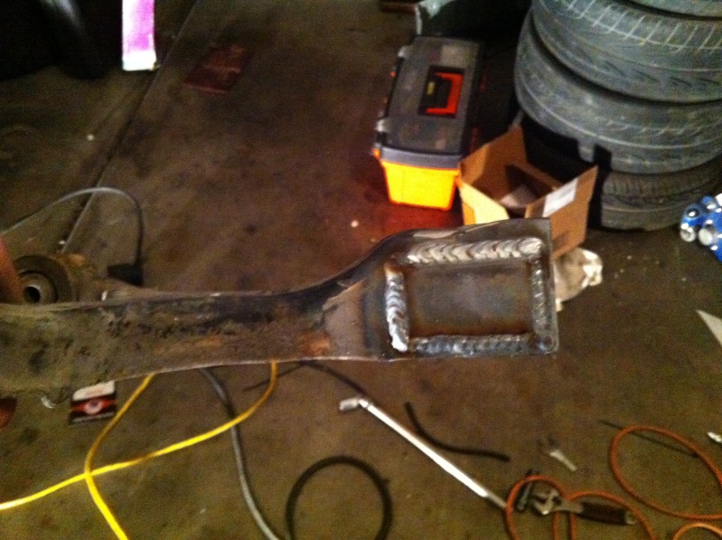

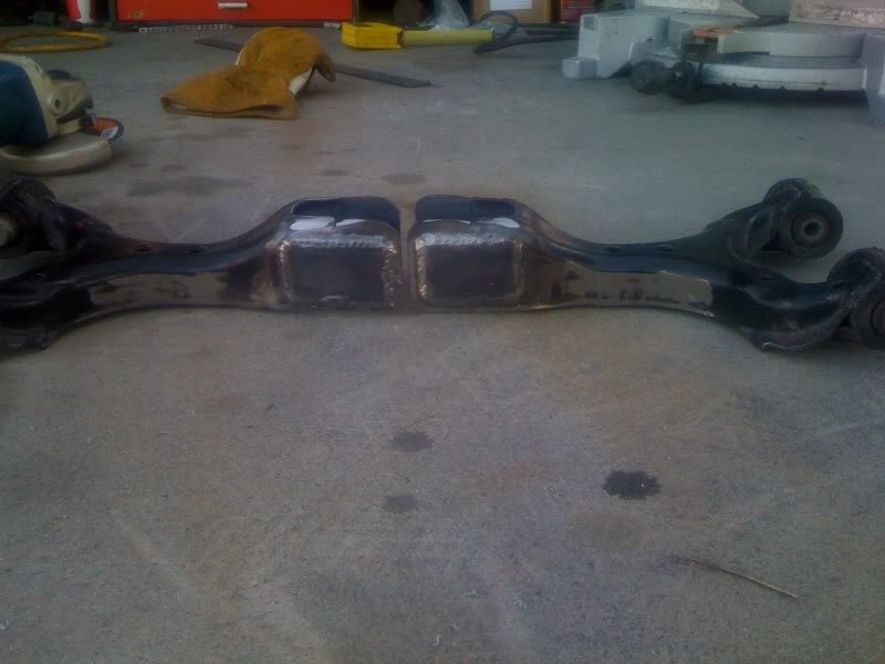

Heres pics of the Extended RUCA's
I believe they only extend them by about 1/8" maybe even 1/16" but dont quote me on that
