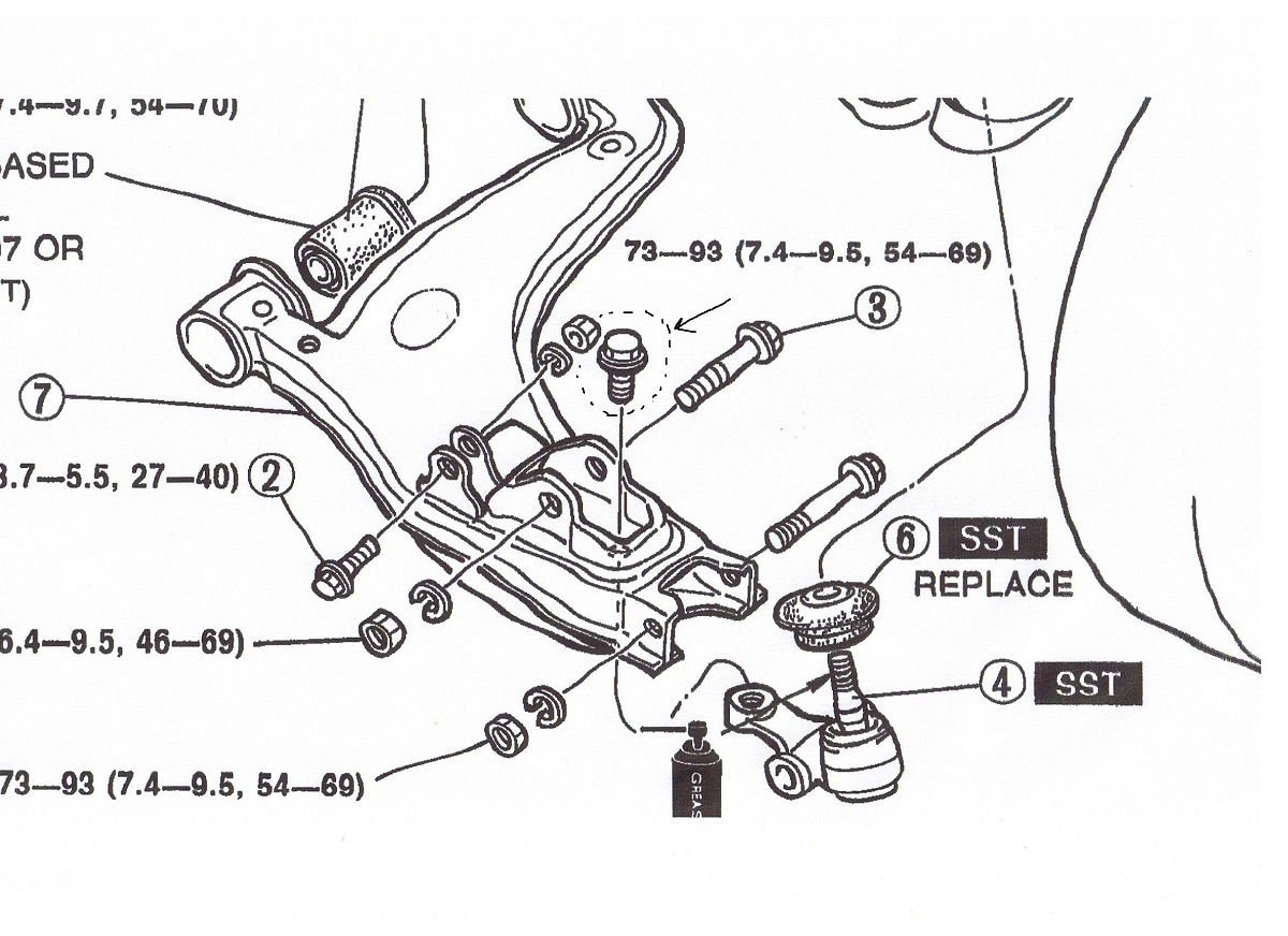

Post by WideOpenThrottle » Sat Nov 19, 2011 8:54 pm
Remove bolt arrowed
