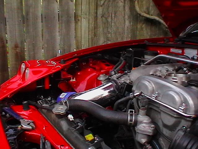

have sorted out my newintake pipe now im sure itll be better than sucking air from the exhaust manifold
fingers crossed that ill be able to drive it home from my workshop on saturday night

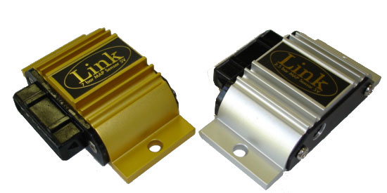

changed all nessesary wires but am having issues with the map sensor and ambient air temp sensors. these are not the original ones from the kit but have been brought from link new
map sensor reads normal but i didnt think the air temp would not let it start thought it would just not let it go into boost

i am only getting 14 kpa i think it should be at 100-103 kpa with the ign on and engine off i am not using the miata link map sensor but the link genuine 2.5 bar map sensor i cant figure it out i thought all map sensors showed the same signals can anyone shed some light?
plugged the ecu in again thismorning to check the map reading again

found a wiring diagram, and found that i get 5v to the map sensor when i bridge the power and ground on the connector but i get 12v if i ground to the chassis. thought that was wierd

i only get 1.5v through the power and ground on the map sensor with the link so i havnt fried it hopefully. cant find 5v, (i was checking with wrong ecu in before) still trying to find a pinout diagram for a miata link. i have e-mailed jeremy at fm and he said they have never had a pinout diagram of their ecu. i just want to know wich input is the map signal to the ecu and run a jumper wire between the fuel cut terminals
