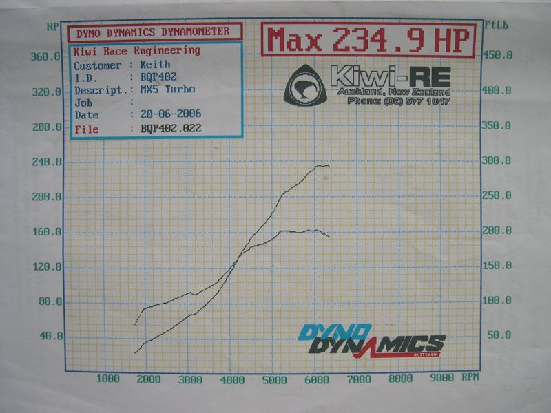

TD05-16g for an 1800 engine is the best turbo around
I'd tried lots (and I mean lots) and nothing comes close in terms of response, power and price.
300hp at the wheels on 20psi is a doddle with room for more scope.
If you want more topend then you can put on a TD05-20g
