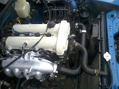

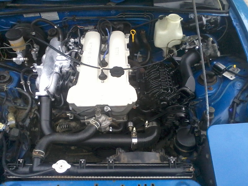

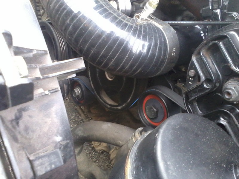

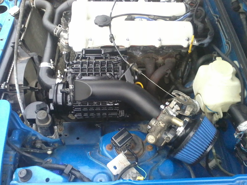

SC14 Supercharger Kit
as promised here's some pics of the newly redesigned supercharger kit.
Got the Miata back from my engineer and he's done an awesome job of it all. And everything is now jigged up ready for production
It's only for the B6 1600 engine - and Air con can't be run - but hey if it's hot enough just put the roof down I reckon
If anyone is interested I can put up a complete parts/price list
