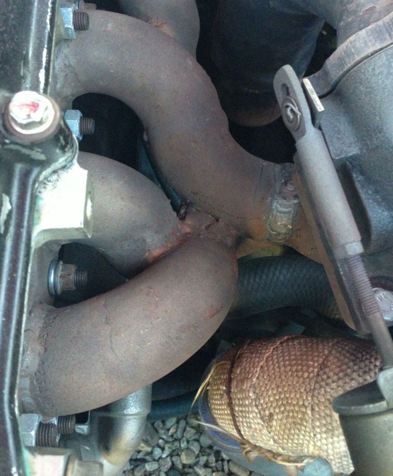

Post by drake21 » Wed Aug 14, 2013 6:30 pm
Here's some photos I'm sorry if its hard to see but the new crack is about an inch from the latest weld .the colour is a bit off for some reason the photos ce out with a bit of rainbow in them .

Post by sprsta » Wed Aug 14, 2013 8:58 pm
weird, that crack is right in the middle of a schedual40 bend, it really shouldn't crack there

Post by drake21 » Wed Aug 14, 2013 9:44 pm
I thought it was a very weird place to crack?

Post by Growler » Thu Aug 15, 2013 2:29 pm
Re-welding it could have heat treated the metal slightly - hence the crack above it...

Post by SLYDIT » Sat Aug 17, 2013 6:42 pm
thats a classic example of overheating the work. you need to do a root run, then let it cool , then do filler runs. if you try to weld it/fill it all in one go you are going to stress the surrounding area.that bit is now toast. youll have to replace it.
