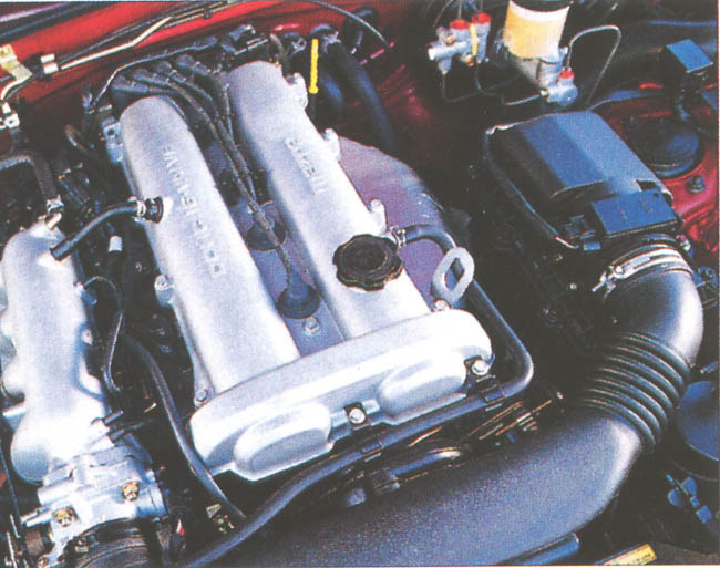

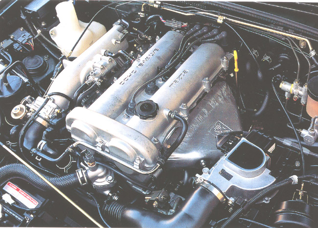

This is THE BEST way to tell:
"The 1600 engine has the coilpacks on the exhaust side of the engine at the rear, the 1800 engine has the coilpacks on the inlet side of the engine at the rear, or on top of the plugs."
Regarding cam covers ..
- The NA (popup headlights) 1.6 has recessed lettering
- The NA (popup headlight)1.8 has raised lettering
- The NB (fixed headlight pre 2005) has recessed lettering on the 1.8
- The NB (fixed headlight pre 2005) was also available in a "povo pack" 1.6lt version, but I don't know what the lettering looks like on those.
The Air Flow Meters also look different.
- The 1.6 one is big and metallic.
- The 1.8 one is only a bit larger than the width of the intake runner and is
black plastic.
Please feel free to add to this discussion, or post your own photos below.

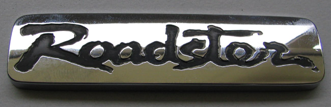

Badge Colour
Have you ever noticed that some Series I MX5s have a different colour in the “Roadster” badge on the rear of the car (See the photos below).
Yes they do!! If you know your colours you can tell a lot about the car.
BLACK – all 1.6 Litre cars(1989 to 1993/94) have black as the colour of the “Roadster” script inside the chrome badge on the rear
RED - The early 1.8 Litre (1993/94) cars had the “Roadster” script changed to red.
GREEN - August 1995 saw the introduction of the 133bhp Series II 1.8 litre engine which featured a 16 bit ECU (Electronic Control Unit) and a lightweight flywheel to let the engine rev more easily. The 4.3:1 final drive ratio was bought back on the 5 speed cars and the “Roadster” script changed to Green

The 1600 (see photo below) have the spark plug leads coming from the coil packs on the passenger’s side of the Cam Cover and have an aluminium air filter cover. The 1800 (see photo) has the spark plug leads coming from the coil packs on the driver’s side and has a larger plastic air filter cover.
