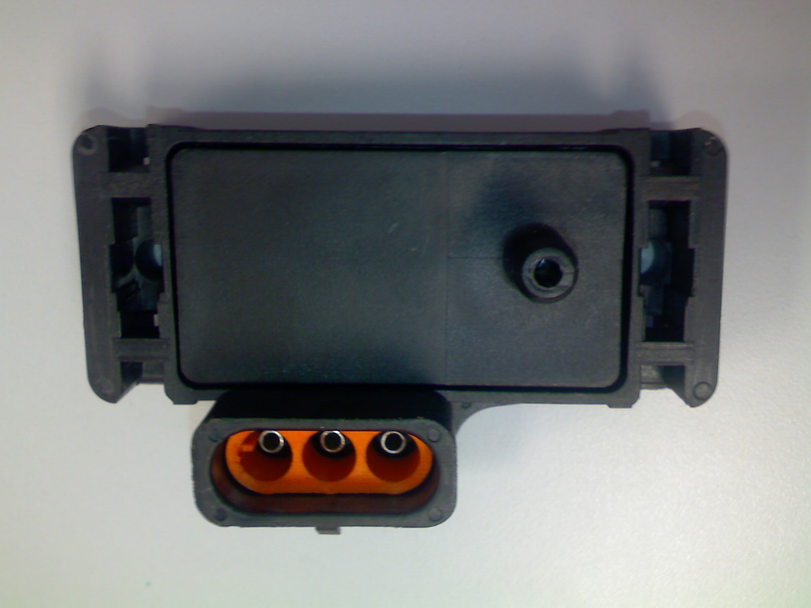

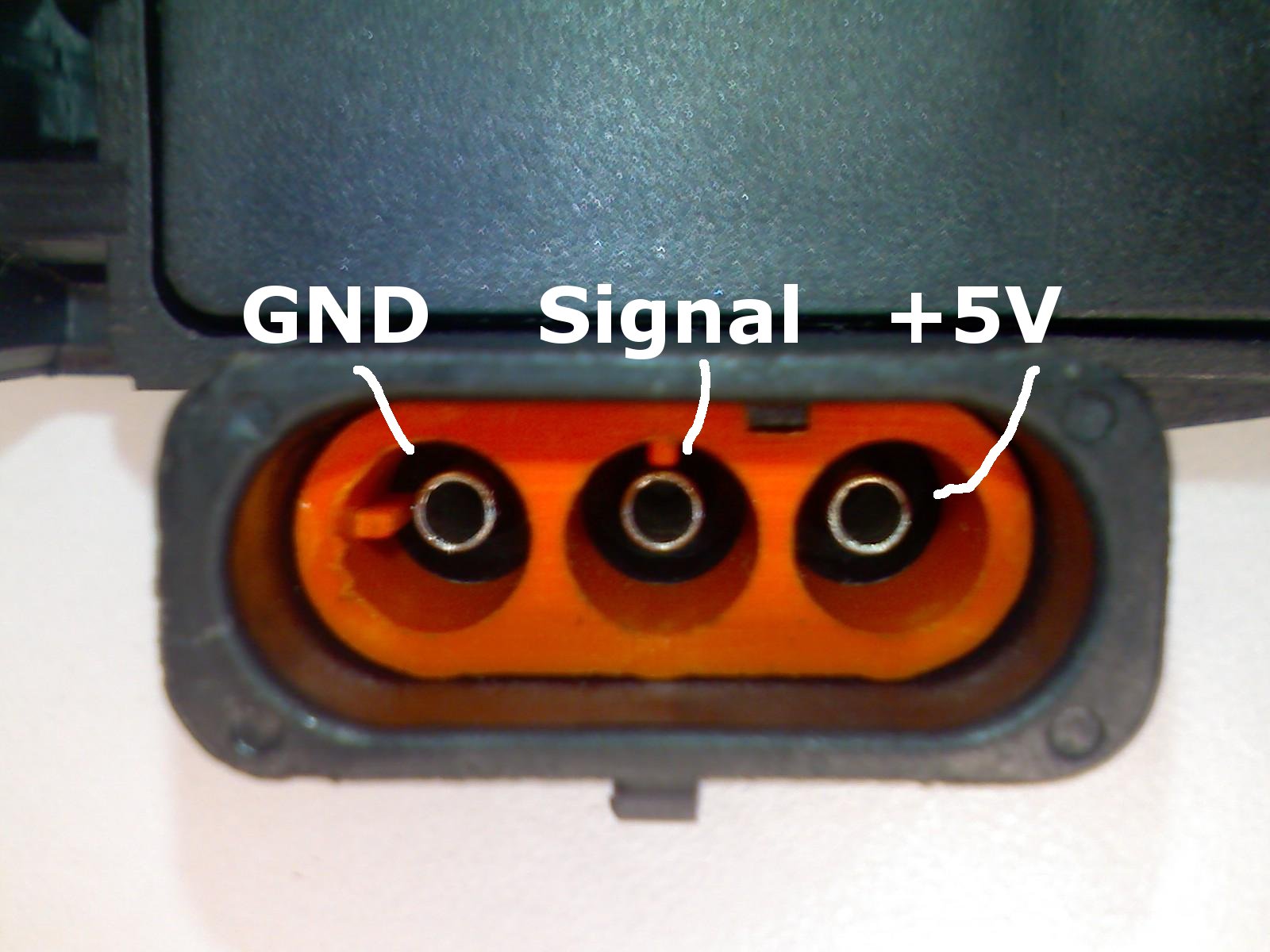

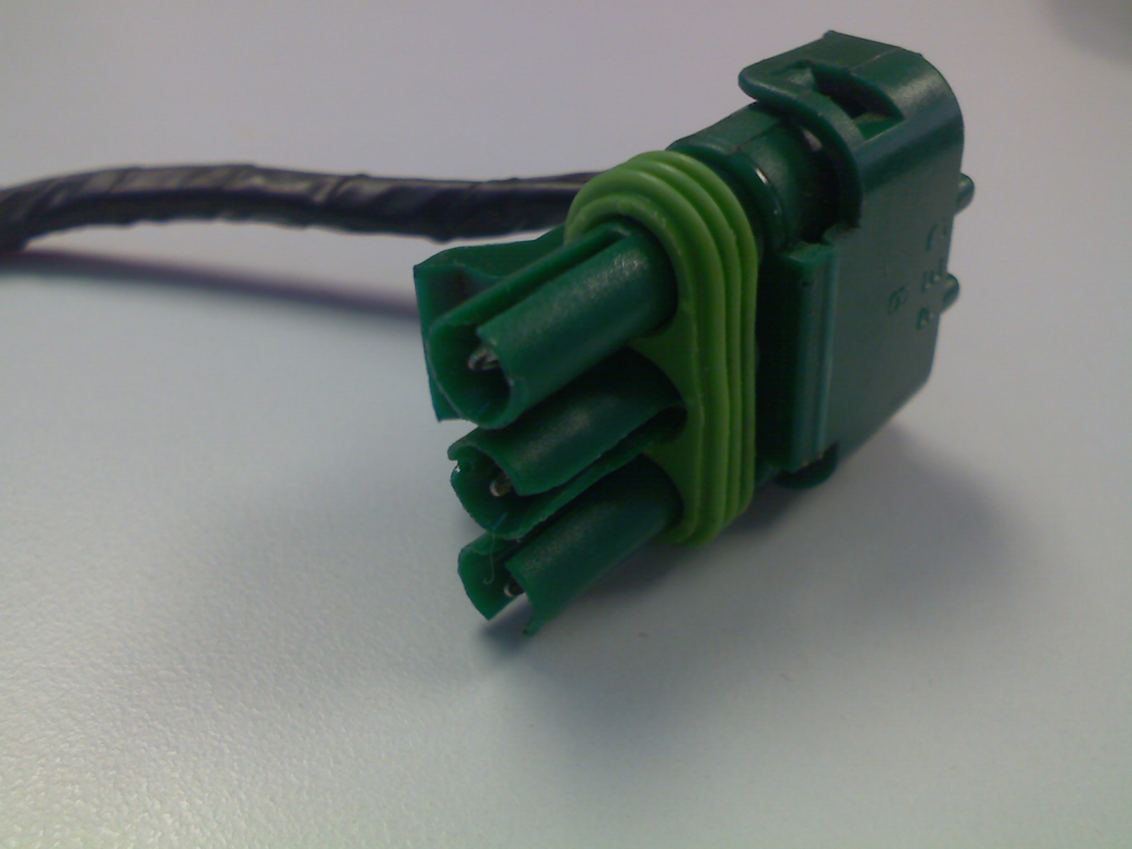

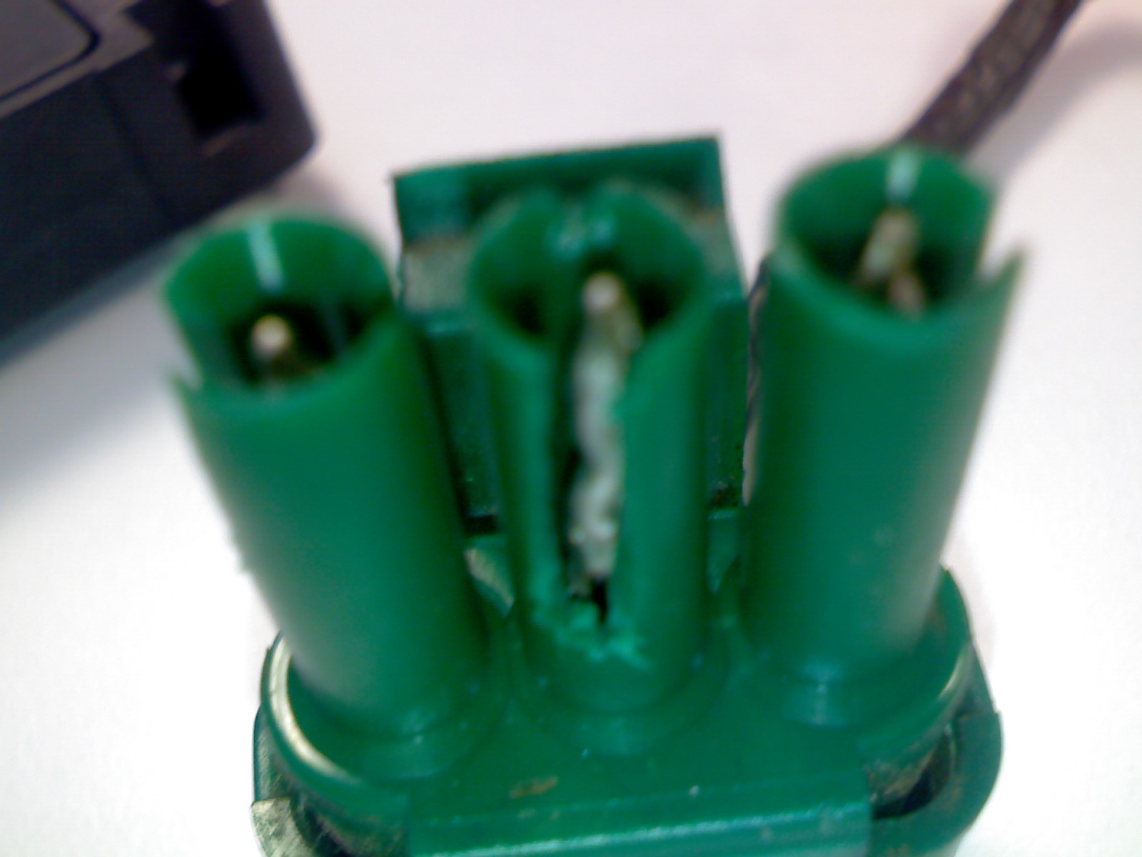

Note that the Orange part of the MAP sensor socket has little mating tabs. One on the left hand socket and one in the middle socket.
Now of course the plug that I was given had different mating slots, and apparently this is due to different aged holden connectors/MAP sensors.
You can fix this by creating mating slots as shown in the pics below. My work is not pretty, but it seems to work OK. Note I could have just created one slot in the middle pin of the plug and mounted the plug upside down, but I wanted the mating clip to work so it didn't have the chance to fall out...
Also, and not shown here, I cut down the green rubber gasket slightly (took about one third off) as the mating clip wouldn't fasten due to the thickness of this gasket.
I cut the slots with a sharp box knife (was pretty easy), and cut the gasket with the box knife and sharp scissors.

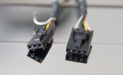

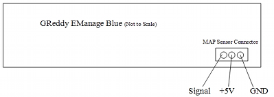

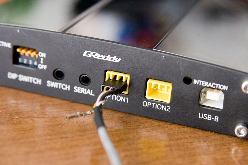

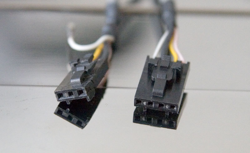

You can purchase a connector for the Emanage to plug the MAP Sensor in, or you can make one from a standard CDROM computer connector (the black inline 4 pin one).
The pics below show how you can trim the last pin off the connector for a CDROM, and it should fit snug into the Emanage socket.
NOTE: The pictures below shows the EManage Ultimate (NOT the Blue) but I understand it is the same. Pics were stolen from the skyline-owners-club forums. (If someone minds... let me know and I'll remove them):
