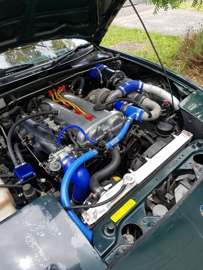

To add onto my setup:
Its a 1992 Mx5, Running a TD04 Greddy kit, Custom intake and exhuast.
Wideband is a Plex sensor which is emulating a narrowband to the Stock ECU.
Leaving the engine off, and turning the IGN on, the Wideband reads AIR.
The Engine managment is a piggyback Emanage Blue with and 4bar map input into it.
It has 330 supra injectors.
I have also changed my spark plug wires to new NGK blues.
I have recently pluged my stock o2 sensor in to diagnose whether it was faulty emulation but the problem still persisted.
The idle switch under the clutch i repaired a few months ago.

Since I'm hoping to dabble in a turbo shortly - what's your PCV hooked up to? Its the only part of the plumbing which doesn't make sense to me in that picture.
Also - our car did some similar things when the bung in the throttle bypass hose came out. I'm not saying that's your issue - it should mean you get a lower AF ratio when in boost. but might be something to check.
