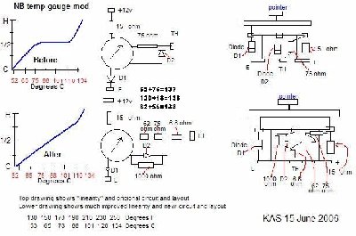

I have done the linearization mod on my NB. It works and I can see when the thermostat opens by the slight drop in reading.
Fletch is right, there is a flat spot from 160F to 225F and the end of scale (=H) is about 250F
PM me if you would like the info. It is fairly easy to do, but some soldering skill and care is required.
Edit, attached the info. There are 2 files and it seems I can only attach 1, I'll post the other.

Thanks for that. Will have to do the mod now and see how it works out.
