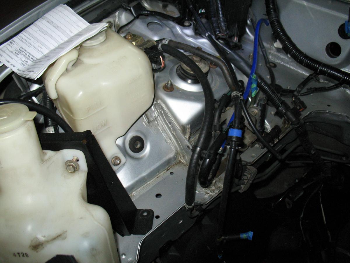

Could just be the Air Flow Meter but thats the closest thing to a fuel mapping sensor on any NA/NB and the car won't start if this isn't working
Only other option I can think of is the Evap canister relay but I removed mine and didn't throw any codes
Try remove the evap canister and loop the lines I can send you some pics of how to do it or just google it and there are hundreds of how to's on it

Try disconnecting this sensor and see if it still throws a CEL (the one behind the coolant tank)
