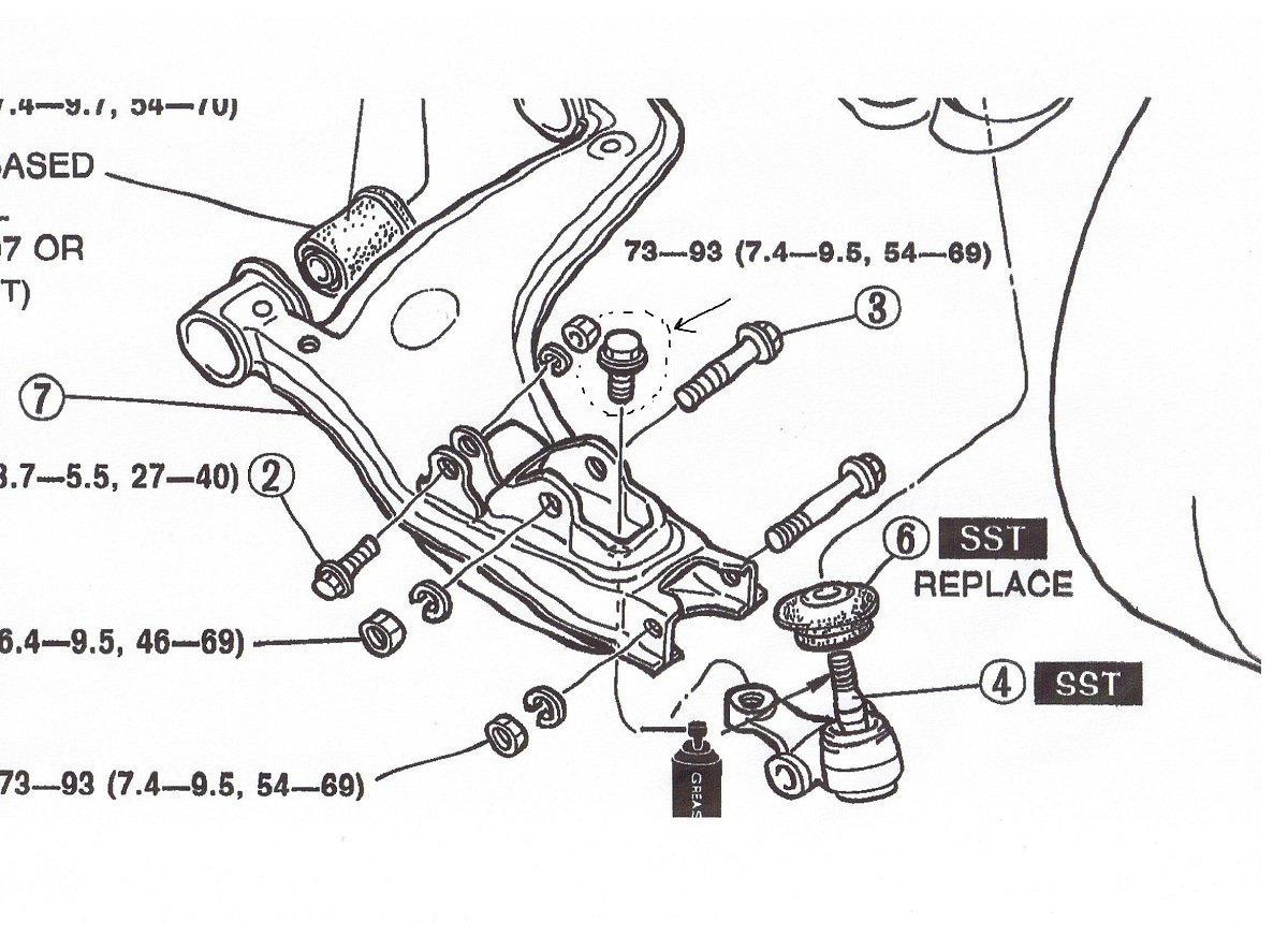

If you don't have a ball joint removal tool you can also separate the assembly at the lower ball joint by removing the 2 bolts that hold the lower knuckle/ball joint to the lower arm. There is a bolt under the lower shock mount and a horizontal bolt through the bottom arm. The ball joint assembly then pulls out of the arm. The only downside of this method is that the upright assembly is hanging from the upper arm which means you have to support that while you push down on the lower arm to give you enough clearance to remove the shock.

Right.......God save the long bolt method!!!!
DONE!
Phew, I even called the mechanic to see if he could fit it in this morning, he was a bit ummmm, aaghhh.
So I decided to give it a go. About an hour and a half to do both sides.
Couple of catches.
The pastic undertray gets in the way, you DONT have to remove it, do the one bolt in the area it is in the way and that part of the plastic undertray can fold under the sway bar out the way.
The second thing is when removing the long bolt it only gets half way out and then hits something. This is an upside down bolt protruding in to the path of the long bolt tha is hard to see, if you track it down and undo it half way it allows the long bolt to slide all the way out....
Oh and when redoing the sway bar up, wait until both sides are undone, it makes getting it back lined up a lot easier.
Special use of the jack to line things up, not a spring compressor in site and all sorted..
