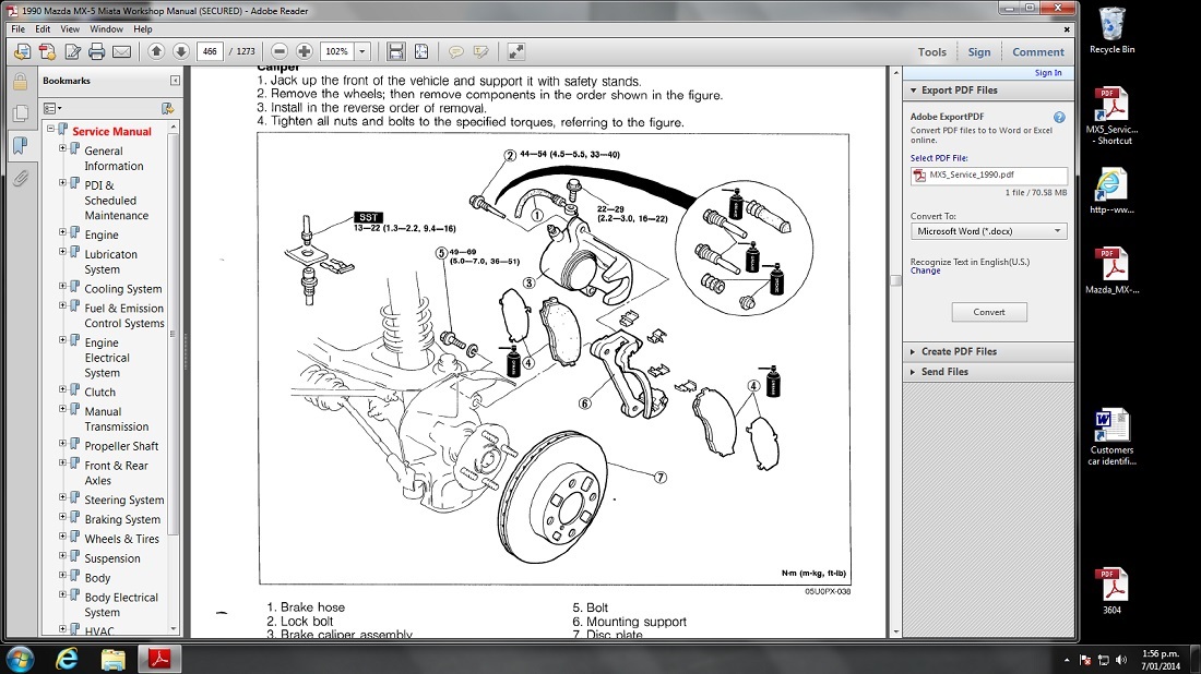

Just had a look at the slider pins and they seem fine, but I bought some Penrite Copper grease anyway as I may as well do them while its apart.
It turns out that the outside pad has been wearing at an angle. The small metal piece on the edge of the pad that slides against the small metal pieces on the caliper had broken off on one side (the thicker side of the uneven pad). Those little metal bits I'm talking about are the pieces 'floating' next to #6 on WideOpenThrottle's image. They probably have a name but you know what I mean.
So I've got a new set of pads, but they didn't come with any of those metal pieces. I'm assuming Repco would stock those as well?
